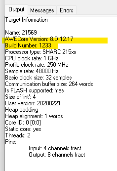

The AWECore version and Build number on your 21569? (Connect via AWE Server, then look at the "Output" tab).

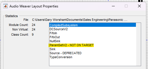

While connected to the 21569, go to AWE Designer and select Layout->Layout Properties.
Scan through all of the Modules. If a module is not on your target, it will be indicated.
