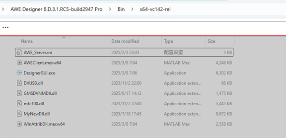

I want to run 64 bit exe file use the following command in Matlab:
>> awe_designer('pickup.awd', 'release64')
Could not locate AWE_Server.exe in Bin directory D:\software\AWE_PRO\AWE Designer 8.D.3.1.RC5-build2947 Pro\Bin\x64-vc142-rel does not exist
can you tell me how to run 64 bit exe successfully ?
Thanks!
12:11pm
Hi Yong Li,
We don't support 64-bit Designer/AWE_Server, which you would need to run an x64 module with Native target (I'm guessing as to your requirement). You will need a 32-bit dll that defines your module.
Thanks,
Gary
