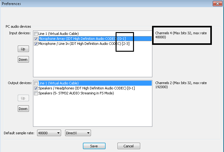

The default Audio Weaver system can only have one HWinput, but I have two hardware audio inputs for my system. I want to have two signal chains, one for each device. How can I achieve this?
In order to wire up more than one device in audio weaver, you have to make sure that the server file->preferences->input devices have more than one device checked. Each device will now have a "channel id" shown after device name.
Once we have two+ devices, we have to manage device signal flow as separate channels in audio weaver. To do this, use the router module. In this example, channel 0 and 1 are device 1, and channel 2 and 3 are device 2.
