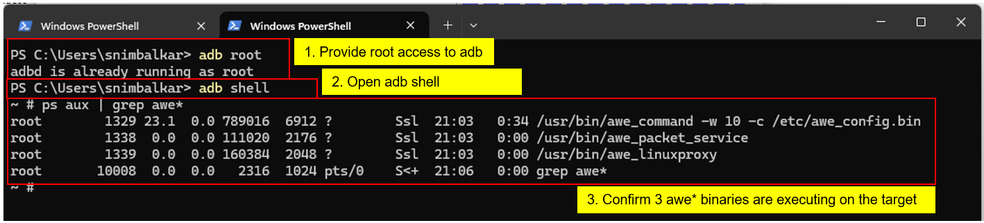

Looks like you were able to acquire AWE-Q, great! Is your board flashed with the ARM and DSP AWECore images?
You can check by doing:
`adb root`
`adb shell`
`ps aux | grep awe*`
This should return 3 awe* process like shown below
Once you see these processes, you connect to the board via TCP/IP connection with IP address 192.168.1.1 in AWE Server.
You may also have to set the TCP/IPv4 ethernet port properties on your PC to use address 192.168.1.10 with subnet 255.255.255.0.
