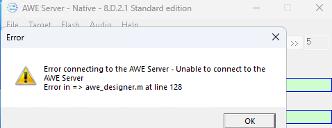

I've confirmed with engineering that Audio Weaver has a lot of 32-bit components and has not been tested or designed for operation with ARM based Windows 11 at this time. It would be nice to get some sort of error during installation, I'll see if that is possible, so that people don't spend a lot of time trying. I'm unaware of any workaround currently. Supposedly Microsoft has talked about releasing the x86 emulator for ARM but only the 64-bit is currently out and only on Windows 11.

Fresh install and I keep getting the error "Can't contact DSP server..." The computer is connected to the internet just fine, the app runs as Administrator, the Windows Firewall is off, all exe's added (manually) to the firewall list for private & public networks for good measure and no anti-virus installed.
Really disappointed in this product, can't even be run after running the installer on a fresh install of Windows 11. Running the AWE_Server.exe from command prompt just opens the UI...

Hi Kevin, Sorry you're having some difficulty.
Did you get the account registration dialog?
When you see this error, are either of the applications "AWE Server" and "AWE Designer" open?
Can you please find the 3 log files located at:
C:\DSP Concepts\AWE Designer 8.D.1.3-Standard\Bin\Assets\logs
(or wherever your install path was) and attach them here?

Hi Gary,
Thanks for your prompt reply. The logs folder is empty... I've tried:
This is a fresh Windows 11 install, just for this. See attached.
Edit: Sorry the the multiple posts, this forum tool is strange. There is save (which is not "Post") and "Preview"... Odd. Can't delete my own posts to clean up the thread.

Hi Kevin, I've searched our database for references to this error. Here's one possible explanation (it's a couple years old so may be completely different). Is it possible that this applies to your case? Do you have Visual Studio installed? In the meantime, go ahead and request the offline license. I don't know how long it will take to get it given it's the weekend.
We found the issue that was happening on some machines. It turns out that the libssl and libcrypto libraries have dependencies on the debug versions of the VCRUNTIME140D.dll and ucrtbased.dll. The standard Visual C++ redistributable only includes the release versions, so only machines that have installed the Visual Studio debug tools will have these debug libraries in place. Copying the 2 libraries from one machine to another allows the AWE_Server to authenticate.
Update - to check, please search for the following files under C:\Windows.

So I did install Visual Studio Code with all C/C++ development extensions (28 GB install) and still no such luck. Just find this a bit strange, its just a fresh install of windows and the product...
My only guess is there is some incompatibility for Windows on ARM somewhere... But the log files are empty, so no help there.

Thanks Gary. I do suspect this is some sort of incompatibility with Windows on Arm... The downloaded VS C/C++ Redistributables are the X86 version (I was expecting X64) when installed through the Audio Weaver Installer (AWE_Designer_8.D.1.3_STMicro.exe) which really shouldn't be the case... There are x64/arm compatible distributions from Microsoft, but installing these didn't work. A fresh install of Windows with those (x64/arm) versions before the AWD installer didn't work, the installer didn't recognize it was already installed, but I proceeded anyways.

Ah I see, it wasn't clear to me. Are you running Audio Weaver ON an ARM based Windows device? Can you provide some more details please?

Yes, but its pretty straight forward. Fresh install Windows on Arm (Surface Pro X), download (AWE_Designer_8.D.1.3_STMicro.exe)...
The installer tries to install x86 C/C++ redistributables, instead of arm / x64 ones. Fine, maybe there's a lot of 32 bit stuff? In any case I get the license error and no logs. Something is a miss for sure.
I'll try the manual license once received, but I suspect more is gong on here than just that.

Update on this, I've installed it on a straight x64 computer and while I did get the UI for Audio Weaver Designer, the same license issue appears. A bit strange, because again this is a fresh install of both Windows 11 and the app from your website. It still errors out that it can't reach the license server...
Really hoping to get this working on my Arm surface though, all the software I have does work and x86/x64 runs just fine... This definitely feels like an incompatibility between the redistributables shipped with Audio Weaver...

Update on this again, I've enabled logging in AWE_Server.ini and at least gotten some log output. Its clearly launching the 64bit version of things. I also see the splash for the GUI (separate from the server splash) but the GUI does not launch. I can't run the GUI exe (DesignerGUI.exe in C:\DSP Concepts\AWE Designer 8.D.1.3 STMicro\Bin\win32-vc142-rel) directly, it says to use the desktop icon.
So all of the DLL's load just fine here on ARM, but the one error I do see is:

4825.500: IBaseCommands::GenerateAudioCapabilitiesLists: leave
4825.500: CAWE_ServerDlg::OnInitDialog: creating sockets
4825.531: CAWE_ServerDlg::OnInitDialog: reading schemas - done
4825.531: CAWE_ServerDlg::OnInitDialog: leave
11:12am
Gary
1:00pm
Thanks Gary, that's what I thought... Okay I'll install this on a old windows laptop...
11:53am
Hello,
Facing a similar issue as the one on top of this thread. Running AWDesigner _8.C.1.3.B_Standard (for dspNexus) on Windows 11 on a Intel PC. The first install a few days ago worked fine. Wanting to flash the DSP, I discovered that the Server window had gone. No way to have it back, namely trying to start AWE_server directly. Exiting the Designer, I was no longer to open it again , error message : "verify that the server is connected to the target,error in designer at line 127".
I have deinstalled and reinstalled AWDesigner twice, no success, as well as the XMos USB Driver for the Nexus. Added the 2 .exe you suggest to add to the firewall exceptions, also turned off both firewalls : no success. Strangely, at the first start after the last reinstall, I was able to open the ini file of the server and to add the XMOSdriver in the setup. Did not work any longer afterwords. Would that be the issue ? All files are supplied by Danville though...
François
12:38pm
Hi François,
Close all Audio Weaver Designer and Server Windows. Now go to Task Manager and make sure that there are no "AWE Designer" or similar processes still running. If there are, right click and select "end task". Then try starting Audio Weaver as usual. Please let me know if this helps.
Thanks,
Gary
12:39pm
Hi François,
Thanks,
Gary
12:40pm
Hi François,
Thanks,
Gary
12:52pm
Hi Gary,
Thank you for your answer. No instance found in the task manager, not even in the background tasks. Perhaps will the issue be more precise now : if (after a new reinstall) in the "File/Global Preferences" menu of the Designer, I click "reconnect to server", it seems to work... But as soon as I try to change the target from Native to Danville Xmos, the server shuts down and refuses to reopen.
Subsequently, no way to reopen the Designer as the Server won't start. Until I reinstall the whole and get a server starting on a "native" target ! So the trouble seems to be clearly located.
Could it come from the fact that the USB on my PC is not an Audio2 but an ordinary USB ? This PC is used only for the development of the filters. But the XMOS driver screen seems to show that the Nexus is well connected...
François
1:20pm
Hi Francois, Unfortunately I do not have Danville hardware here to test with so all I can do is guess. What is the difference between this system and another one which (presumably) works? Have you tried the most recent build of Designer (8.D.2.6)? Look at the recently generated log files (in 8.D.2.6, these are located in C:\DSP Concepts\AWE Designer 8.D.2.6 Standard\Bin\Assets\logs). Is there any clue there as to what is going on?
Thanks,
Gary
1:28pm
Gary,
I guess there must be some peculiar development in AW for Danville, making it necessary to stick to the release I just got from them. I will have to see that with Al Clark. I will report here here anyway. Do you agree that the issue may stay with that move from "native target" to the XMos one ?
François
10:51am
Finally, it was a matter of changing parameters in the ini file of the server.
But the connexion with the DSP remains quite unstable, though possible.
